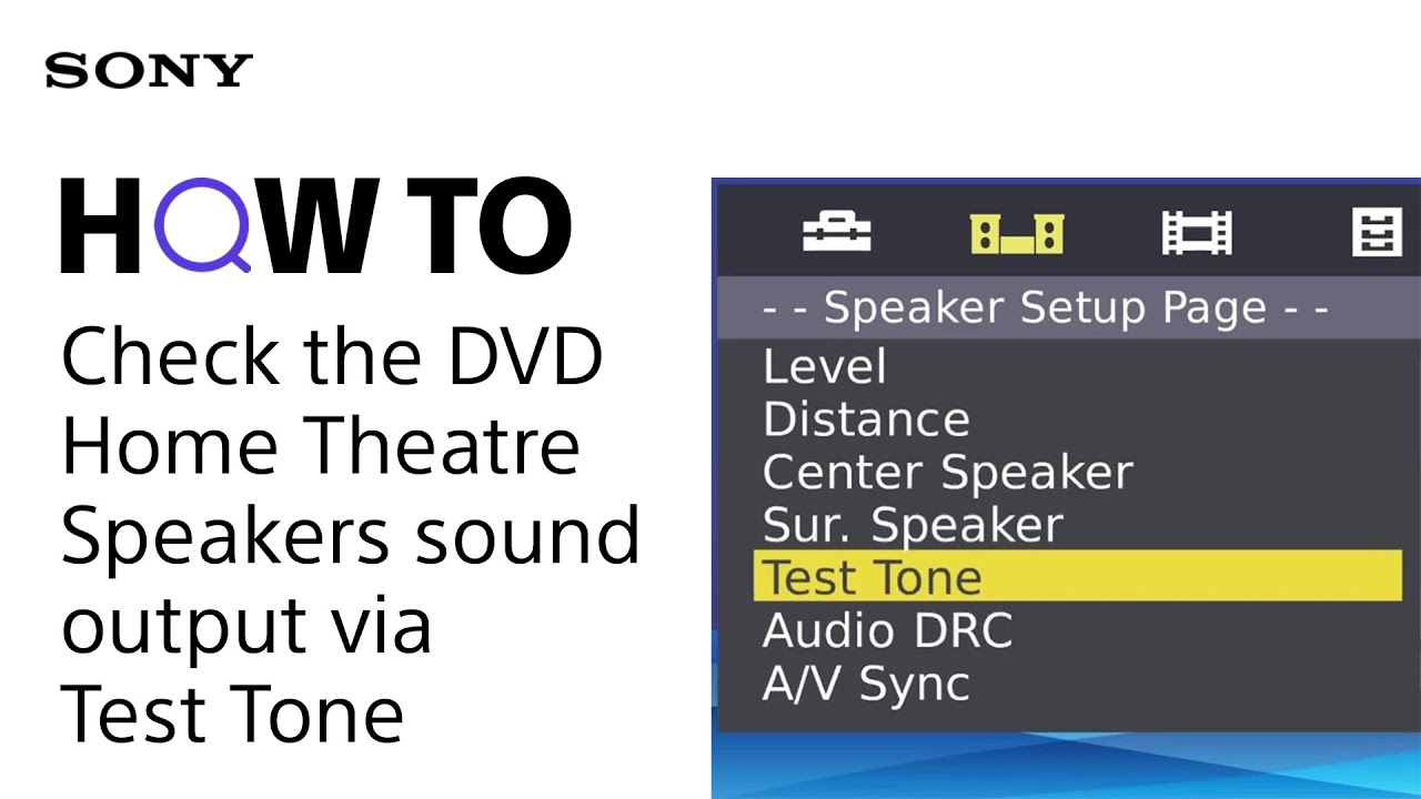

[VIDEO] How to check the DVD Home Theatre Speakers sound output via Test Tone Settings
    If you experience no sound from any or all of your speakers of your DVD Home Theatre System, you can follow the steps in this video and do a test tone to check on the sound output of each speakers.
