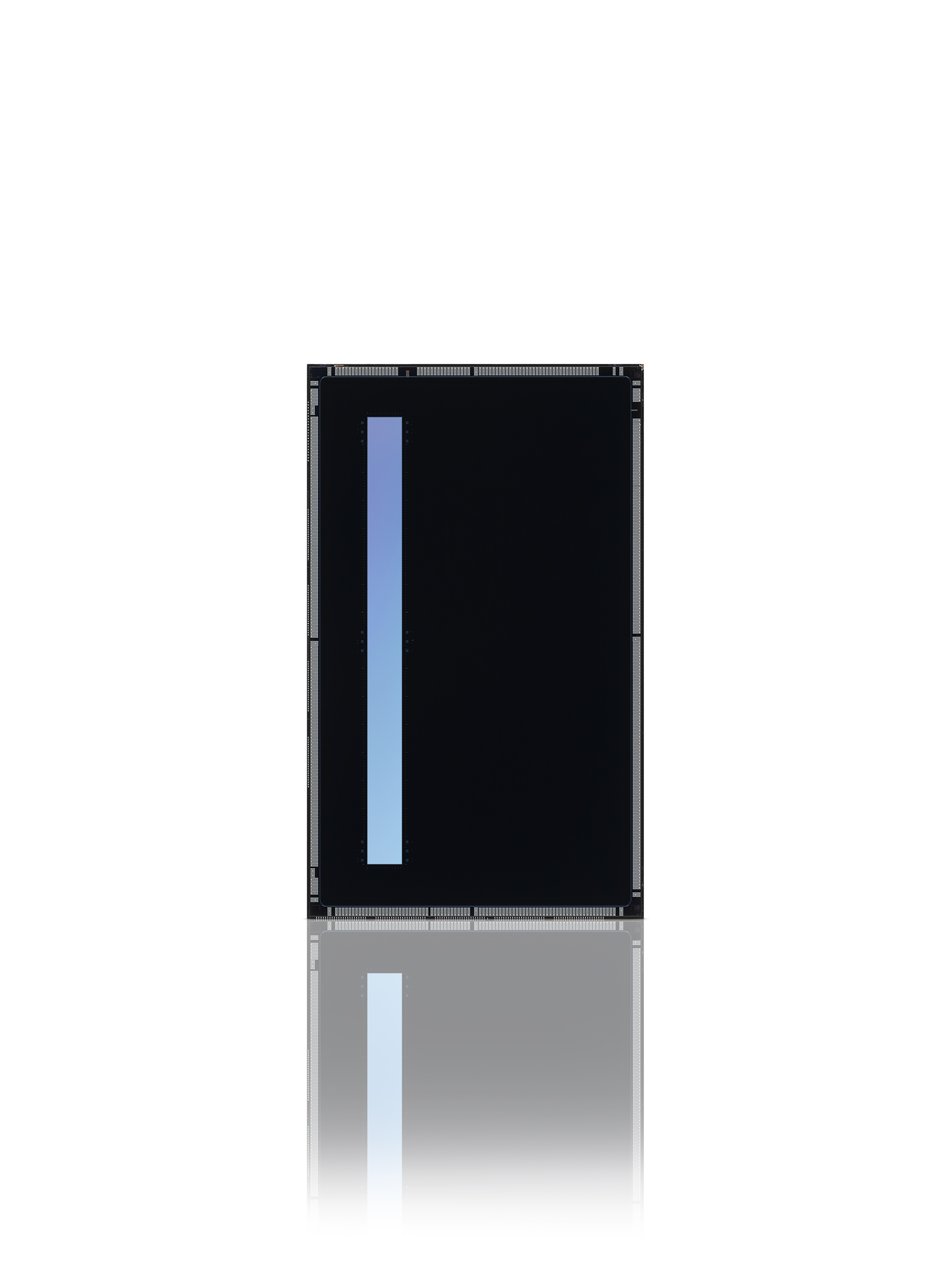

Sony Semiconductor Solutions Corporation (SSS) today announced the upcoming release of the IMX479 stacked, direct Time of Flight (dToF) SPAD depth sensor for automotive LiDAR systems, delivering both high-resolution and high-speed performance.
The new sensor product employs a dToF pixel unit composed of 3×3 (horizontal × vertical) SPAD pixels as a minimum element to enhance measurement accuracy using a line scan methodology. In addition, SSSs proprietary device structure enables a frame rate of up to 20 fps*1, which is the fastest for such a high-resolution SPAD depth sensor having 520 dToF pixels.*2
The new product enables the high-resolution and high-speed distance measuring performance demanded for an automotive LiDAR required in advanced driver assistance systems (ADAS) and automated driving (AD), contributing to safer and more reliable future mobility.

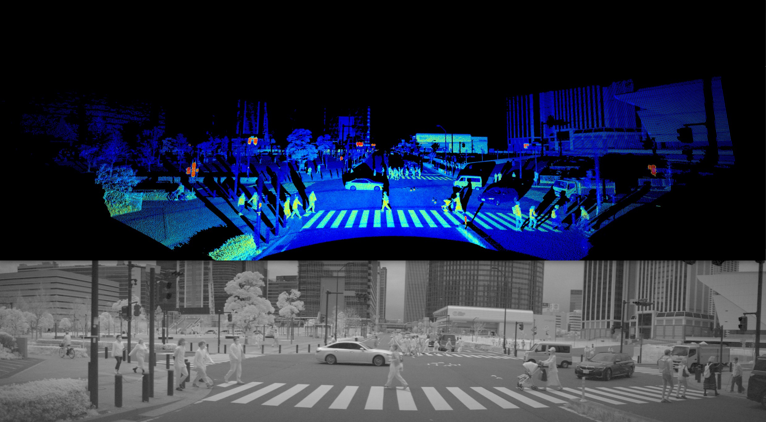

LiDAR technology is crucial for the high-precision detection and recognition of road conditions and the position and shape of the objects, such as vehicles, pedestrians. There is a growing demand for further technical advancements and developments progress in LiDAR toward Level 3 automated driving, which allows for autonomous control. SPAD depth sensors use the dToF measurement method, one of the LiDAR ranging methods, that measures the distance to an object by detecting the time of flight (time difference) of light emitted from a source until it returns to the sensor after being reflected by the object.

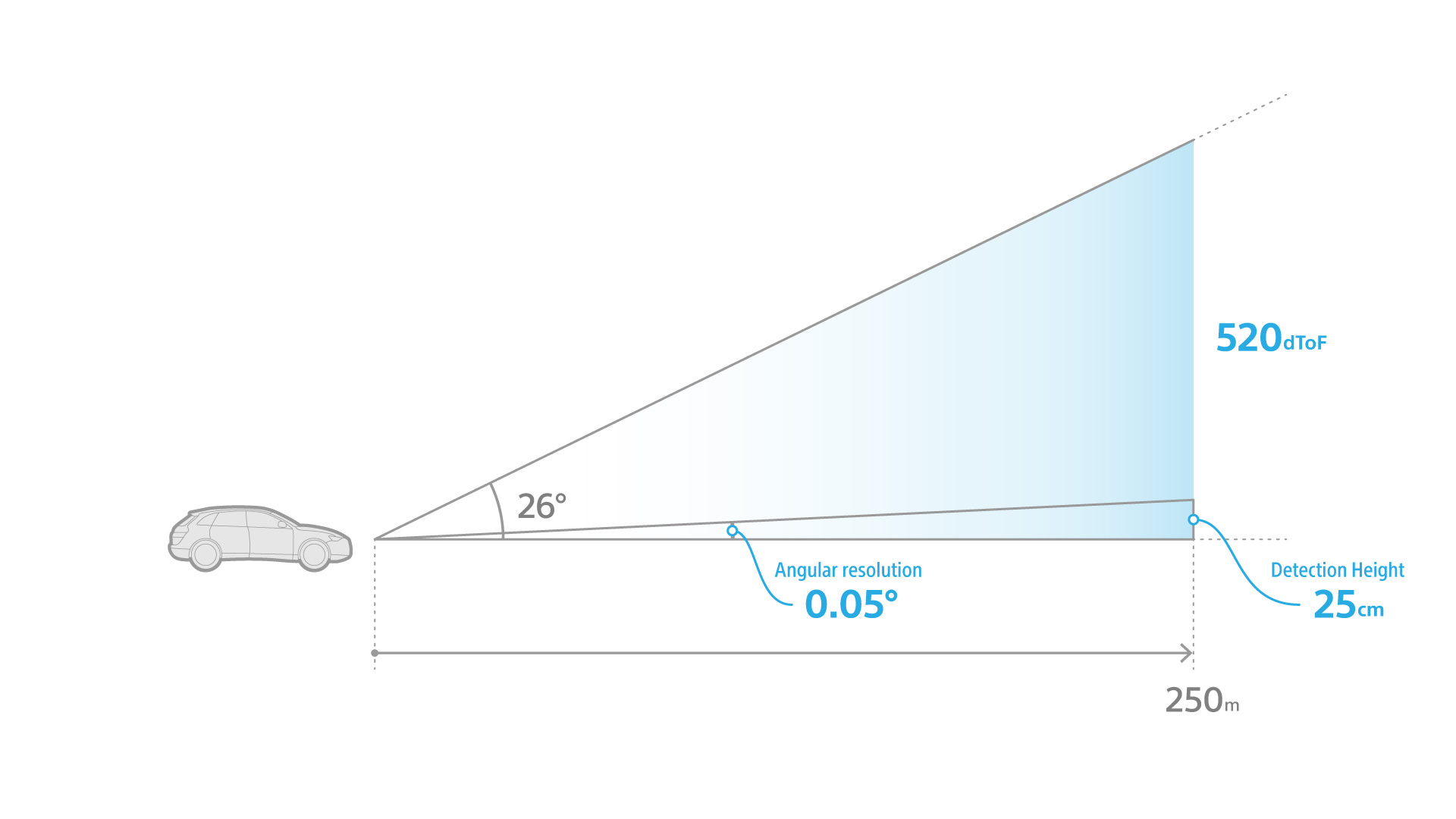

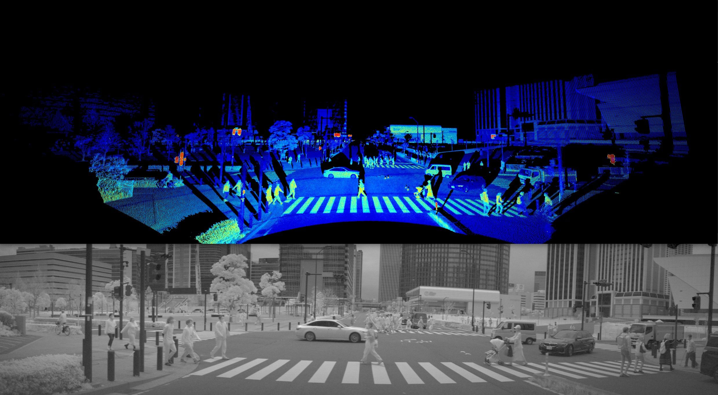

These technologies achieve a frame rate of up to 20 fps, the fastest for a 520 dToF pixel SPAD depth sensor.*1 They also deliver capabilities equivalent to 0.05 degrees vertical angular resolution, improving the vertical detection accuracy by 2.7 times that of conventional products.*5 These elements allow detection of three-dimensional objects that are vital to automotive LiDAR, including objects as high as 25 cm(such as a tire or other objects in the road) at a distance of 250 m.

The proprietary circuits SSS developed to enhance the distance resolution of this product individually processes each SPAD pixel data and calculates the distance. Doing so successfully improved the LiDAR distance resolution to 5 cm intervals.

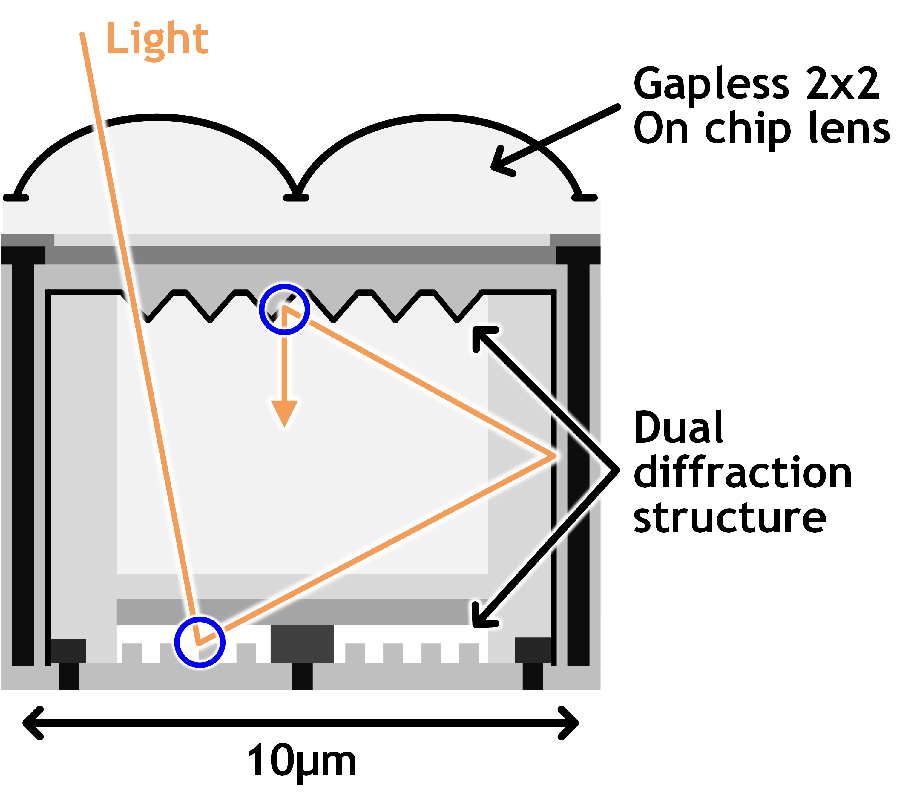

■ High, 37% photon detection efficiency enabling detection of objects up to a distance of 300 m
This product features an uneven texture on both the incident plane and the bottom of the pixels, along with an optimized on-chip lens shape. Incident light is diffracted to enhance the absorption rate to achieve a high, 37% photon detection efficiency for the 940 nm wavelength, which is commonly used on automotive LiDAR laser light sources. It allows the system to detect and recognize objects with high precision up to 300 m away even in bright light conditions where the background light is at 100,000 lux or higher.
SPAD Pixel cross-sectional structure

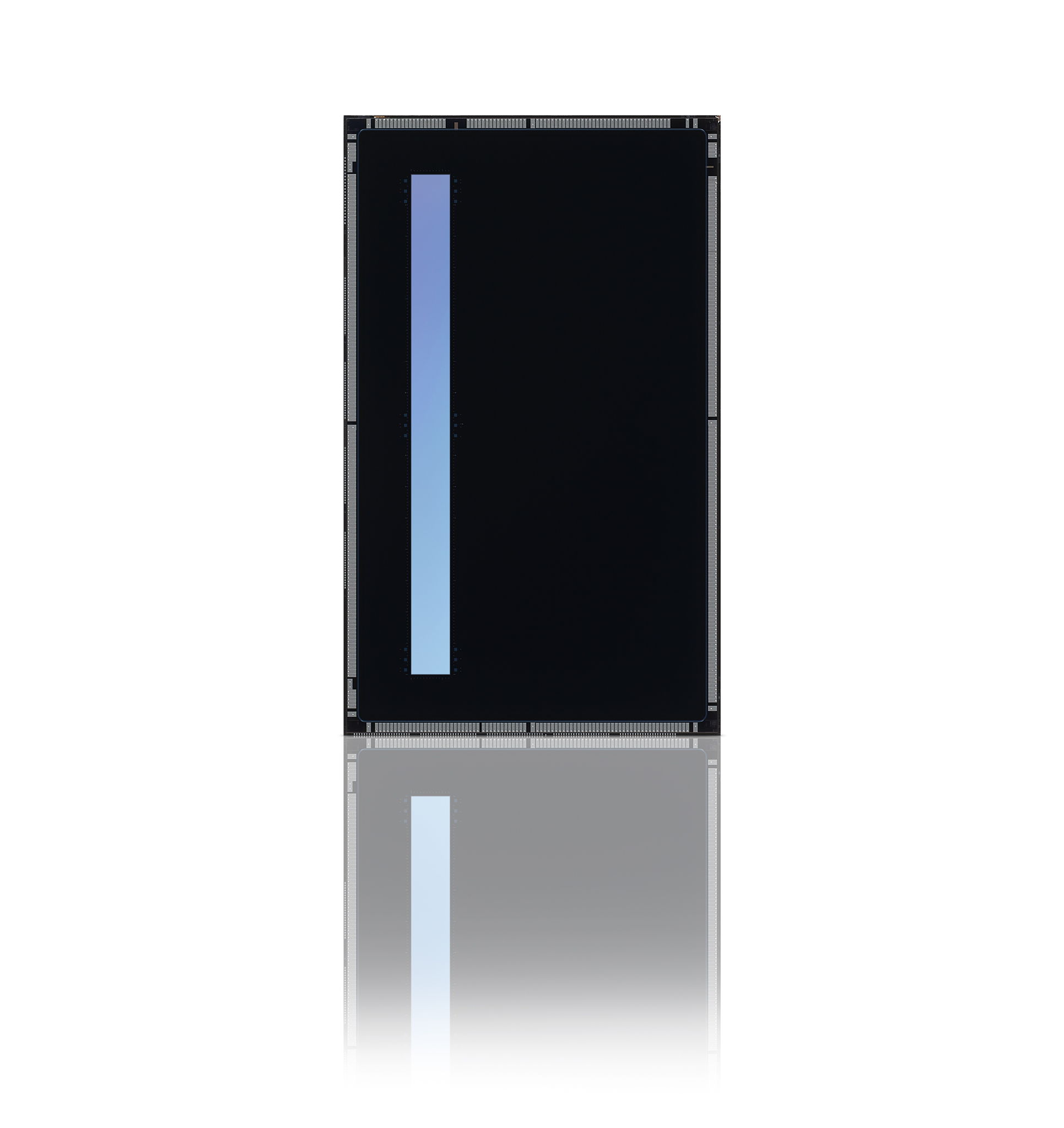

Key Specifications
Model name
IMX479
Effective SPAD pixels
105 × 1,568 pixels (H × V), approx. 164,000 pixels
Vertical effective dToF pixel count
520 dToF pixels
Image size
Diagonal 15.8 mm (1-type)
Recommended light source wavelength
940 nm
SPAD unit cell size
10.08 μm × 10.08 μm (H × V)
Element size (dToF pixel unit)
Minimum 3 × 3 (H × V)
Photon detection efficiency
37% (940 nm wavelength)
Response speed
Approx. 6 ns
Power supply
SPAD breakdown voltage
−20.5V
SPAD excess voltage
3.3V
Analog
3.3V
Digital
1.125V
Interface
1.8V
Interface
MIPI CSI-2 serial output (4 lane)
Chip size
12.2 mm × 20.0 mm (H × V)
Max. detection distance
300 m
Distance precision at 300 m
Minimum 5 cm equivalent

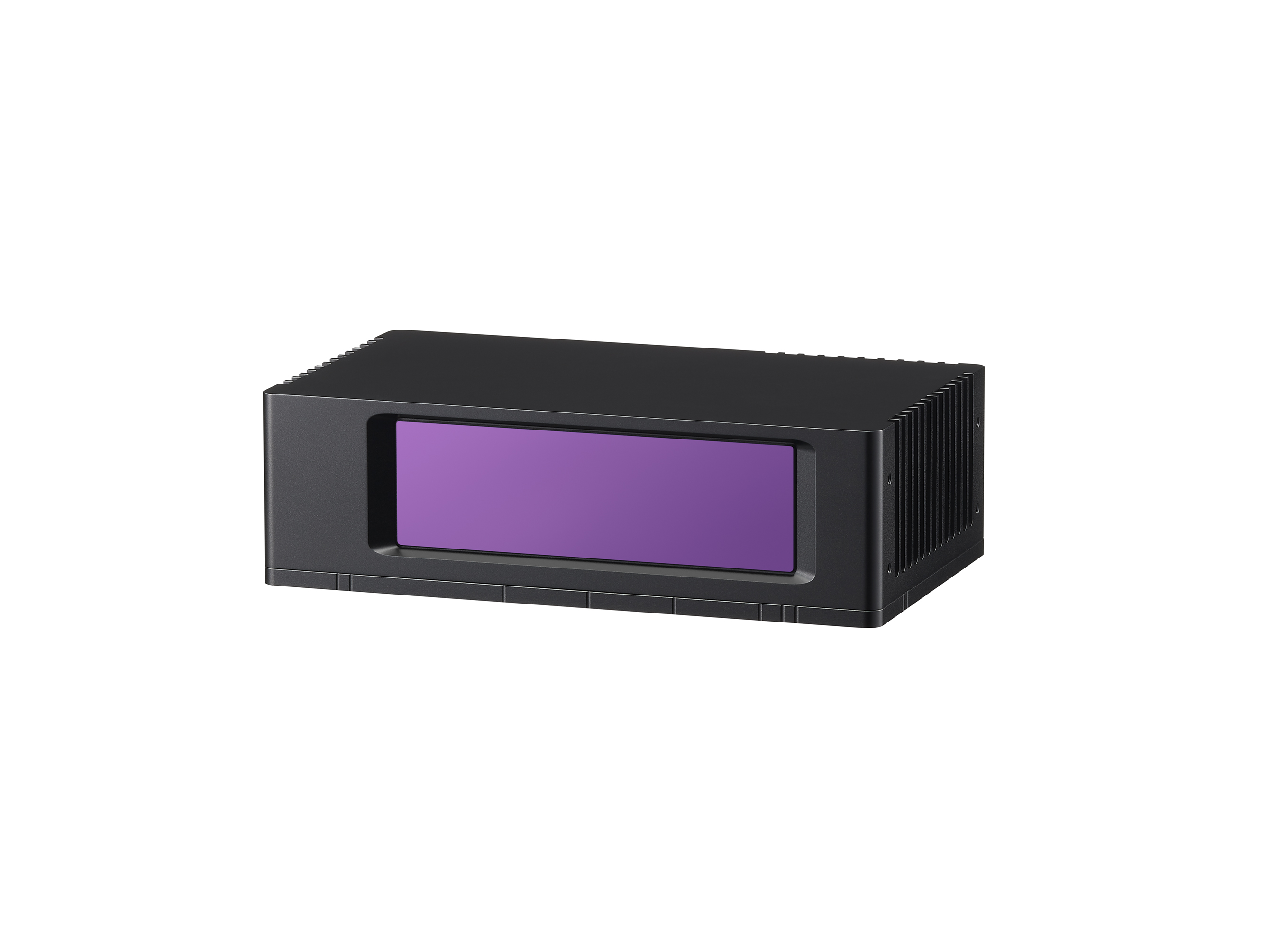

Mechanical scan LiDAR for evaluating the product
SSS has developed a mechanical scanning*6 LiDAR unit equipped with this new sensor for product evaluation, which will be provided to customers and partners. This will contribute to customer and partner LiDAR development and product evaluation initiatives.
*6 A method in which a rotating mirror reflects the beam from a fixed laser light source for wide area horizontal scanning.
