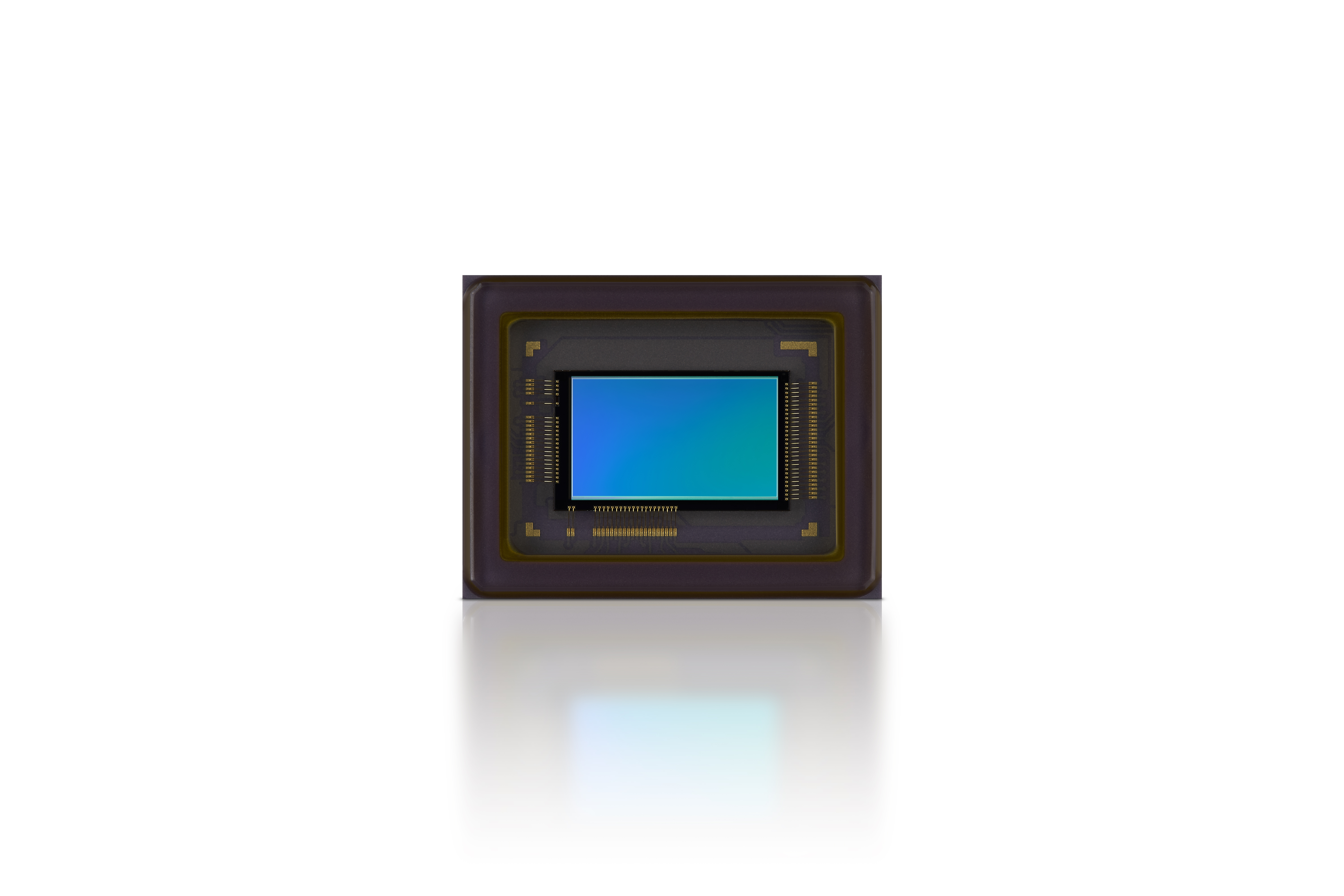

Atsugi, Japan — Sony Semiconductor Solutions Corporation (Sony) today announced the upcoming release of the IMX908, a 4K CMOS image sensor for security cameras with the industry’s smallest*1 1.45 µm LOFIC*2 pixels.

Key Specifications
Model name | IMX908-AQR1 |
Image size | Diagonal 6.42 mm (1/2.8 type) |
Effective pixels | 3,856 (H) × 2,180 (V) Approx. 8.4 megapixels |
Unit cell size | 1.45 μm (H) × 1.45 μm (V) |
Frame rate | 10bit: 90 fps 12bit: 60 fps |
Input drive frequency | 24 / 27 / 37.125 / 72 / 74.25 MHz |
Power supply | 1.1 / 1.8 / 3.3 V |
HDR support functions | Clear HDR*7 (30 fps, 16bit) |
SNR1s | 0.53 lx |
Dynamic range | 96 dB (Clear HDR3) |
Output interface | MIPI D-PHY 2 / 4 Lane |
Color filter | Bayer |
Package | Ceramic LGA AR coating Size: 12.0 mm (H) × 9.3 mm (V) |
*7 Uses internal compositing.
