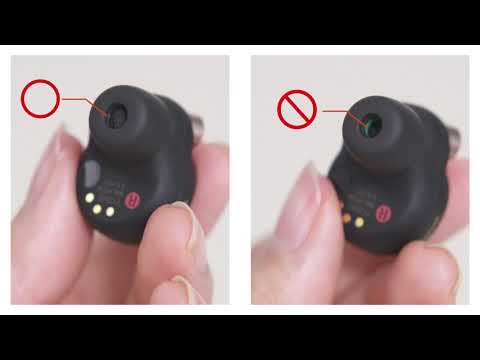

    3. Replace the earbud tips
    Firmly insert the earbud tip all the way. If the earbud tips are not attached completely, they may come off the headphones and adversely affect the sound quality, noise canceling performance, and wearability.
    Check the followings:
    • Make sure the earbud tips are not attached in a skewed manner
    • Make sure the earbud tips are inserted firmly all the way
    For how to attach the earbud tips, refer to the following:
    Note: Look in the center of the earbud tip to confirm that the stem color (orange, green or light blue) cannot be seen.
    • The earbud tip is attached correctly (stem color cannot be seen):
    • The earbud tip is attached incorrectly (stem color (green) can be seen):
