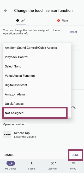

    This issue can be caused if the touch sensor is tapped inadvertently. If this happens frequently, you can disable the touch sensor by changing the function of the touch sensor to None Assigned using the Sony | Sound Connect app.

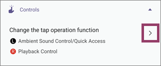

    1. Open the Sony | Sound Connect app, and select Device settingsControls.
    2. Select right arrow icon at the right side of the Change the touch sensor function or Change the tap operation function menu.
    3. Select Not Assigned, and then tap DONE.
