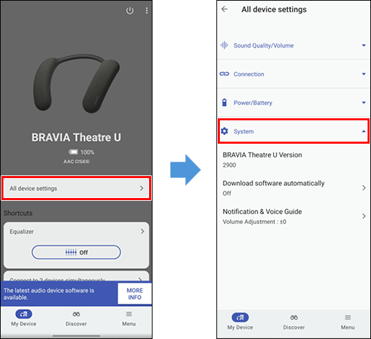

  1. Launch the Sony | Sound Connect app.
  2. Connect your speaker to the Sony | Sound Connect app.
  3. Scroll down the app, then tap All device settingsSystem in the red box of the app.
    Sony | Sound Connect app screens. The first image shows the [My Device] screen with [All device settings] displayed in the center. The second image shows the [System] menu with the software version displayed.
  4. Software version shown in the Menu. The version is shown only when the speaker is connected.
  5. Confirm the firmware version.

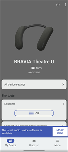

  3. The Dashboard screen will appear when the connection has been established.

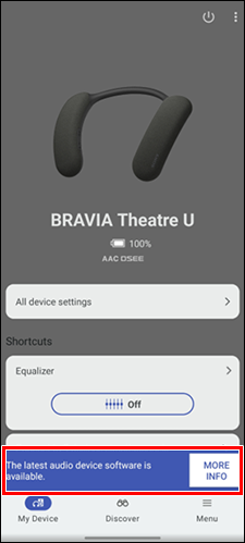

  4. If an update is available, “The latest audio device software is available.” message will appear. Press MORE INFO to continue.
    The message and [MORE INFO] button will be displayed at the bottom of the screen.

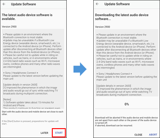

  5. Verify that Version 2900 is displayed, then press START to begin the update.
    The first image shows [LATER] and [START] buttons at the bottom right of the screen. The second image shows the software download progress.
  6. Once the download starts, the next screen will automatically appear after the download is complete.

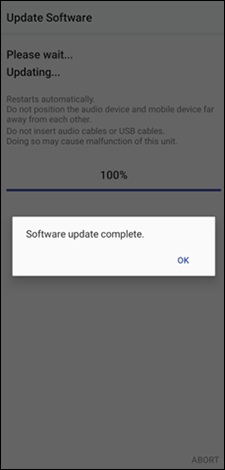

  8. When the software update is complete, press OK.
    • If the “Software update complete.” screen does not appear, proceed to Step 2 below to check whether the version has been successfully upgraded.
    The message and [OK] button appears in the middle of the screen.
