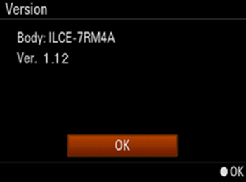

Follow the instructions below to check the system software version:
  1. Select Menu → Setup6 → Version → Body.
  2. The system software version will be displayed.

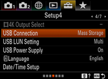

    1. Select Menu → Setup4 → USB Connection.
    2. Check that Mass Storage has been selected.
      If a different mode is selected, change it to Mass Storage.

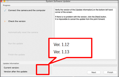

  6. Turn on the camera and connect it to the computer using the supplied USB cable. USB Mode will appear on the LCD screen of the camera.
  7. Click Next. The current version number and updated version number will appear on the lower left side of the screen.
    IMPORTANT: Never turn off the camera or disconnect the USB cable while the update is in progress.
    Note: If the computer cannot find the device, the message “Could not find the camera for this update” will appear on the computer screen. Try the following:
    • Disconnect the USB cable and reconnect it.
    • If the computer has multiple USB ports, try a different port.
  8. After confirming that the current software version is Ver. 1.121.12 or earlier, click Next. If the current system software version is Ver. 1.13, the update is not required. In this case, follow the steps below:
    1. Disconnect the camera from the computer.
    2. Click Finish.
    3. Turn off the camera.
    4. Remove the battery pack.
    5. Reinsert the battery pack.
    6. Turn the camera back on.
    • When an update is required:
      The [Current Version] on the lower left of the screen is showing 1.121.12 or earlier, and the [Version after the update] is showing 1.13.

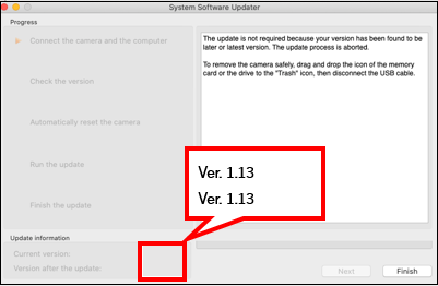

    • When an update is not required:
      The [Current version] and [Version after the update] are displayed as 1.13 at the bottom left of the screen.

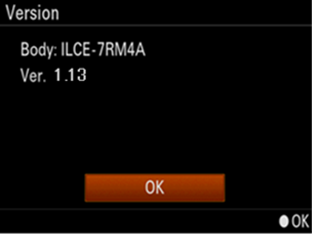

Step 3: Confirm the System Software Version of Your Camera
